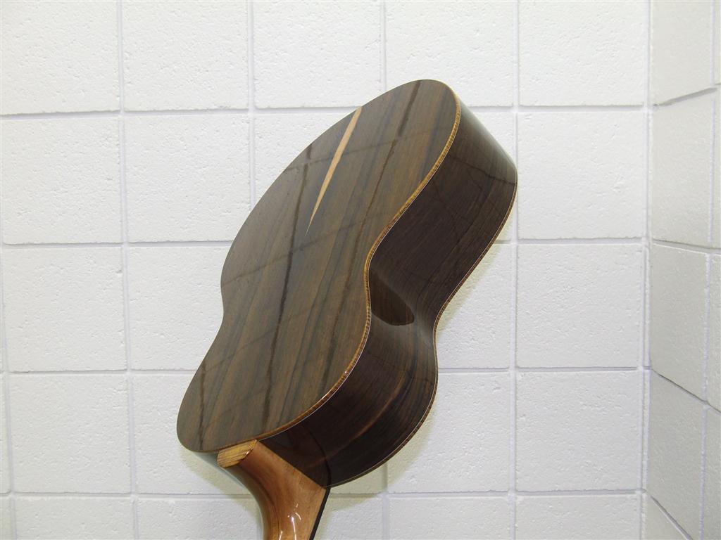

Very handsome guitar Lance. That MBW is exceptional and the rosette is just right. Just the right size, and just th eright color, perfect.
I did not know that you have your guitars finished with the neck on. Does Tony charge extra for that? I know some other finishers that do.
PostPosted: Sun Jul 08, 2007 12:14 pm
Thanks John,
I have been scaling back all my appointments, bindings and rosettes especially, I really like the very sleek slim look.
Its the same price regardless if the neck is attached or not. This is my first (with) the neck attached.

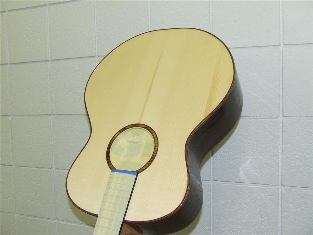

Beautiful! I notice you don't mask off the area for the bridge. What is your procedure for getting the bridge attached?
PostPosted: Mon Jul 09, 2007 2:23 am
Thanks Wayne,
I usually do mask that area off, but I was in a hurry to get this one in for finish, so I didn't bother.
What I will do is mask off the area around the bridge and use a dremel and a down cut bit to remove the finish up to 1/8" in from the edge of the bridge. My bridges have an 1/8th" x .005 relief cut in the bottom edge, so they will (fall) into the hole so to speak, so I don't have to remove the finish ALL THE WAY to the edge.

I have thought about doing my bridges that way as well. How to you cut that relief?

Yes, How DO you cut that relief cut?

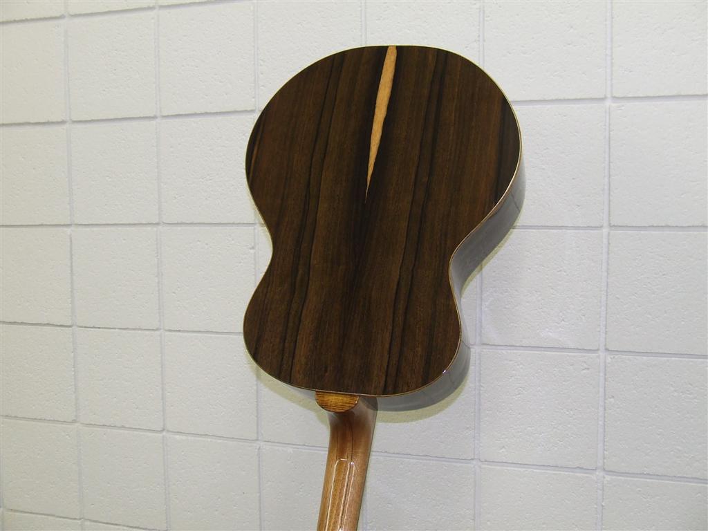

I especially like the heel cap.

[QUOTE=John K] Yes, How DO you cut that relief cut? [/QUOTE]
I have a 30' radius and 1/8th" X .005 relief cut cnc'd into my bridges. Email me for contact info if want

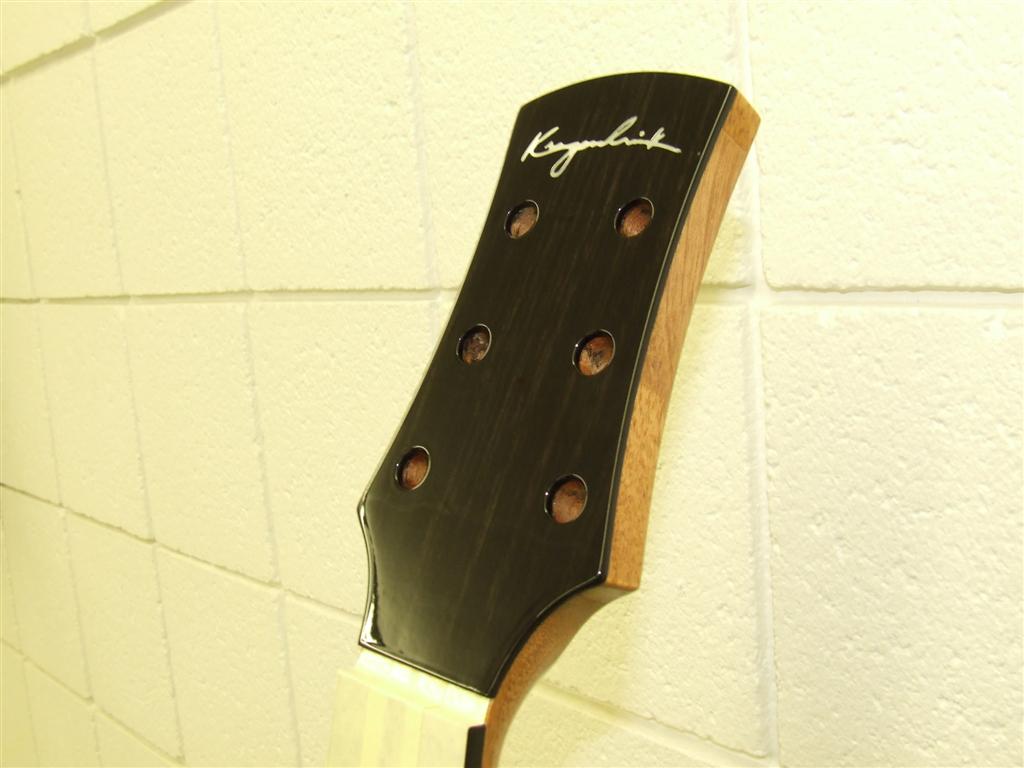

love that script logo, very cool!

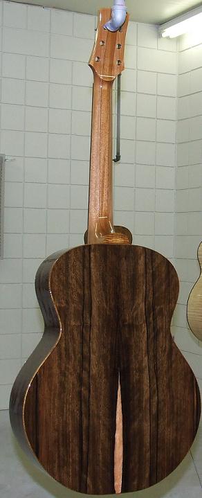

Hesh, the MBW worked very nicely. I don't know what to compare it too though - It sanded great, bent predictably, It seemed easer on the tools than say rosewood, but maybe that was just this one piece, I duno?
I DO know tho that it has moved up on my list of favorite woods. I have three more super nice sets that I will be trying to talk people in to letting me use
